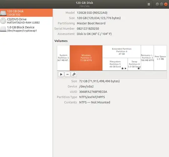

I bought a ibm thinkpad t430used and it came with Windows 10.
Since my SSD is only 120GB I wanted to remove windows, and reallocate that current 72GB that Windows 10 is using to my ubuntu install.
How can I do that?
My partitions currently look like: img
Can someone please help? Thanks.

  1. Use the application called Gparted in the Live USB.
  2. Make sure the correct hard drive is selected.
  3. Delete the partition /dev/sda2 above. Note that it may be called something else when you use the Live USB.
  4. Apply the Changes (Nothing happens until you Apply)
  5. Now Windows is gone for ever, so is all the documents, music etc. you saved in Windows.
  6. Highlight the Extended Partition 4 in the above picture. This may be called /dev/sda4. Note, inside this extended partition, there are two logical partitions. /dev/sda5 and /dev/sda6. Our final goal is to increase the size of /dev/sda5. But to that we need to make room for it in /dev/sda4.
  7. Expand the /dev/sda4 to the left to take up all the empty space created by deleting /dev/sda2.
  8. Apply the Changes.
  9. Highlight /dev/sda5.
  10. Expand the /dev/sda5 to the left to take up all the empty space created inside /dev/sda4.
  11. Apply the Changes.
