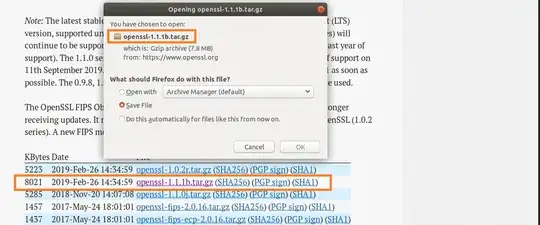

Step 1 : Download openssl 1.1.1b
Download the latest openssl 1.1.1b release from from Ubuntu source package….
OpenSSL Cryptography and SSL/TLS Toolkit
enter image description here Figure-1: Download openssl 1.1.1b
You can also easily install openssl 1.1.1b package by running the commands below…
wget https://www.openssl.org/source/openssl-1.1.1b.tar.gz

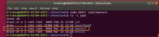

Now create /opt/openssl directory:
$ sudo mkdir /opt/openssl enter image description here Figure-2: Create folder for openssl under /opt directory.

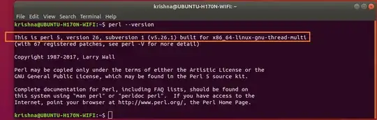

$ perl --version enter image description here Figure-4: Perl version.

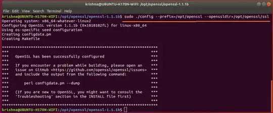

Issue the config commands:
 $ cd /opt/openssl/openssl-1.1.1b
 $ sudo ./config --prefix=/opt/openssl --openssldir=/opt/openssl/ssl
enter image description here Figure-6: config command

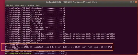

Issue make test command to check for possible errors:
$ sudo make test
enter image description here Figure-7: Bingo! All tests successful.

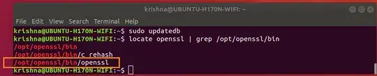

Where is openssl binary being located?
Issue the following commands:
$ sudo updatedb                              # rebuild library cache
$ locate openssl | grep /opt/openssl/bin
enter image description here Figure-8: Locate openssl binary.
