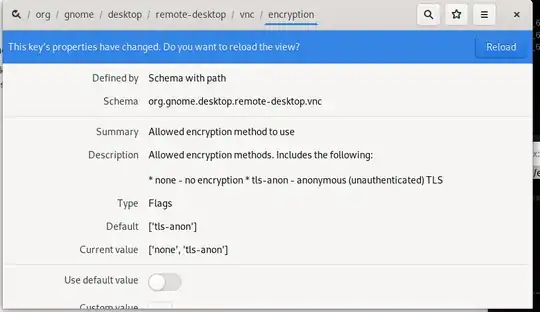

My VNC server vino / gnome-remote-desktop-daemon, uses tls-anon by default, and it won't respond to gsettings. Here's what worked:
  1. Install dconf-editor
  2. Change org.gnome.desktop.remote-desktop.vnc to include 'none' in the array value
Use SSH tunneling for security.
source: Confirmed working on wayland
source: https://gitlab.gnome.org/jadahl/gnome-remote-desktop/issues/24

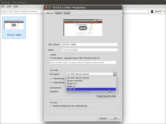

If the VNC server doesn't require encryption, you must setup the VNC client also to do not use encryption or to let the server choose. For the current version of RealVNC Viewer 6.19 (it is free):
  1. Choice Properties on the connection you want to modify.
  2. In the General tab, for Encryption set Prefer off or Let VNC Server Choose.
The above screenshots are from the Linux version of RealVNC Viewer, so they can looks slightly different.
