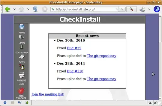

Checkinstall is up-to-date.
The correct link is http://checkinstall.izto.org/ with Recent news from Dec 30th, 2016 and it is shown on https://packages.ubuntu.com/focal/checkinstall :
link
Checkinstall
$ apt-cache show checkinstall | grep Homepage
Homepage: http://checkinstall.izto.org
And git repository is also fresh:
$ git clone http://checkinstall.izto.org/checkinstall.git
$ cd checkinstall/
$ git log | head -n3
commit d24a630501a9aba5d53de2dcb3d9aa66edd3fe06
Author: Felipe Eduardo Sanchez Diaz Duran <antispam>
Date:   Wed Apr 26 17:37:50 2017 -0500
