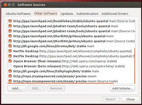

why don't you just open up software and sources : software sources
and untick all the problematic sources,
then close software and sources (let it reload sources)
and try updating again.
you don't want to be using sources that don't match your distribution. first repair updates then one by one add versions of those PPA made for your distro and check that they don't break updates at each one.
