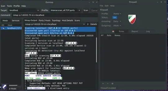

Here is an nmap scan of my system along with my firewall config, showing the open ports on my system: enter image description here

Explanations for nmap and gufw image (I think this is what you want)
Your nmap shows the only two open ports are open to 127.0.0.1. This is a special IP address that refers to the computer itself. That is, the computer itself can talk to itself using these two open ports.
The gufw screenshot shows that there is no firewall rules setup. However, since you installed gufw and clicked on it, ufw is also installed (gufw uses ufw) and ufw is active. The default ufw configuration you mentioned above, deny (incoming) and allow (outgoing) is working. However, these rules don't apply to the computer itself, that is 127.0.0.1. This is (not necessary but) sufficient for a home user.
