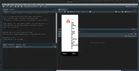

My RStudio has suddenly started to crash when opening a file (R or Rmd).
I get this weird pop-up and I have to force kill it. This error also pretty much freezes all other open applications like browsers.
RStudio opens up fine. I can run code in the console and that works. I can create a new file and run code from there. But, if I try to save that file, then it gives this error. So far it's only when I save or open R/Rmd files. R through the terminal works perfectly fine too.
This started yesterday when I filled up my disk and ran out of space. Then I couldn't save anymore obviously. Since then I have cleared space on my drive. There is 35GB of free space on my drive. And the system has been rebooted.
I have tried to remove the .rstudio-desktop directory from my home. That didn't help. Then I uninstalled and reinstalled RStudio. That didn't help either. Anyone has any ideas?

EDIT: Error logs added as suggested.
Ran journalctl -f and got as below:
Mar 15 14:41:05 elmo systemd[1]: Starting Process error reports when automatic reporting is enabled...
Mar 15 14:41:05 elmo whoopsie-upload-all[14945]: ERROR: whoopsie is not running
Mar 15 14:41:05 elmo systemd[1]: apport-autoreport.service: Main process exited, code=exited, status=1/FAILURE
Mar 15 14:41:05 elmo systemd[1]: apport-autoreport.service: Failed with result 'exit-code'.
Mar 15 14:41:05 elmo systemd[1]: Failed to start Process error reports when automatic reporting is enabled.
Ran rstudio from the command line and got below:
load glyph failed err=6 face=0x2372ac0, glyph=2798
[1]    14976 killed     rstudio
Rstudio crashed and was killed in both cases above.
I am experiencing a similar problem and found out that switching display driver to NVIDEA binary driver instead of nouveau driver solved out the problem.
check it out https://bugs.launchpad.net/oxide/+bug/1499419
Deleting this file /home/user/.config/QtProject.conf.lock solved the problem.
