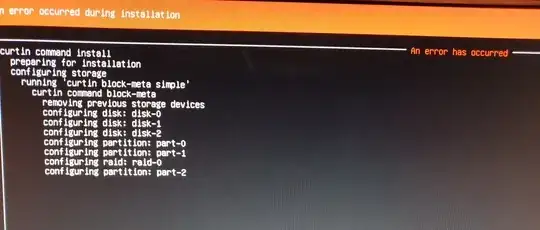

But I get the following answer on the following step:
Error message on install
What am I doing wrong with my RAID?

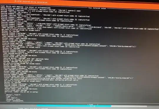

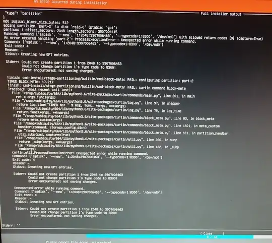

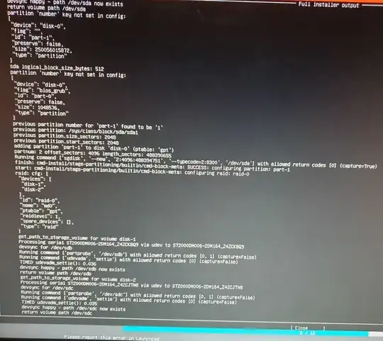

I went back to that problem after a while, and I realized there is a log. So here some photos of the log of the operation. Sorry, but I can't retrieve the log file, as there is no OS installed on the machine:
Error log extract - part 1 Error log extract - part 2 Error log extract - part 3
