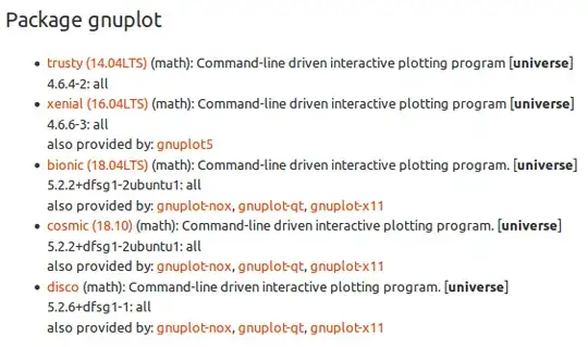

At first please note that GNU Plot is packaged in all Ubuntu versions:
binary gnuplot package
