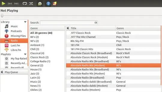

The image shows the default RadioTray radio stations imported into Rhythmbox
How did I do that?
