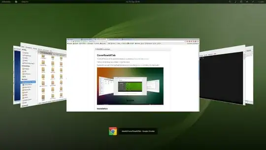

You can use the Coverflow Alt-Tab extension for GNOME shell. It's a
Replacement of Alt-Tab, iterates through windows in a cover-flow manner.
Refer to this for installing and managing GNOME extensions: How do I install and manage GNOME Shell extensions?
