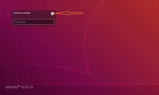

  4. Now you are greeted by Unity login screen. What a warm feeling to have it back!

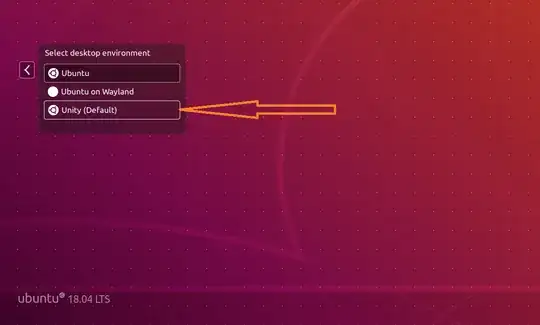

    Double-click Ubuntu symbol in LightDM or gear symbol in GDM to display options for desktop environments.
    The default desktop environment is now Unity. You can click the Ubuntu icon to choose another desktop environment if you want to.
  5. If you upgraded from Ubuntu 16.04/17.10 to Ubuntu 18.04 and the login screen was replaced with the one from GNOME desktop, you can restore Unity login screen by running the following command:

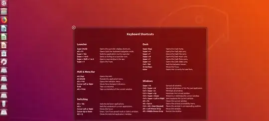

    And here’s the good old Unity desktop.

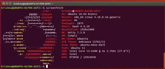

  6. Checking Unity Version
    You can use the screenfetch tool to check Unity desktop version.
    $ sudo apt install screenfetch
    Now, give the following useful command to display not only version info, but also other system details:
    $ screenfetch
    As you can see, we have installed Unity 7.5.0.
    You can also acquire Unity version by running the following command.
    $ unity --version
