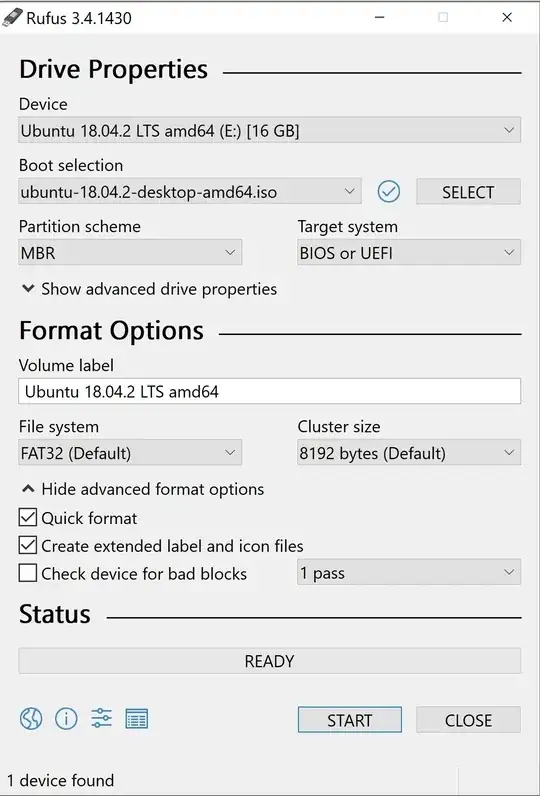

Rufus Burning Pendrive
Already Windows is installed. I am trying to install dual boot Ubuntu 18.04 on windows 10. But when I have selected "Install Ubuntu", Ubuntu is loading in Pen drive but not in Hard Disk. I am getting message "You need at least 8.6 GB disk space to install Ubuntu". How to install Ubuntu in Hard disk but not in pen drive. Attaching Images of Disk Management and Rufus Pen drive burning.
Thank you.

To get Dual boot working fine on your Dell laptop, follow these steps:
Section - I: Getting Windows OS ready for Dual-boot
  • Login to your Windows machine with an Administrative account and right-click on the Start Menu >> Command Prompt (Admin) option to open Windows Command Line with elevated privileges
  • Once you are in the command prompt, type diskmgmt.msc to open "Disk Management Utility". From here, right click on the "C:" partition and select Shrink Volume in order to resize the partition
  • On "Shrink C:" enter a value to shrink in MB and hit the Shrink option to start partition resize
Note: Do not forget to create a Bootable USB having Ubuntu loaded into it before you start with the next section.
Section - II: Installing Ubuntu OS
  • Reboot the machine and instruct the BIOS/UEFI to boot-up from the DVD/USB by pressing a special function key (usually its F12, F10 or F2 depending on the vendor specifications)
  • Once the media boot-up, a new Grub screen should appear on your monitor. From the menu select Install Ubuntu and hit the Enter key to continue
Note: After the boot media finishes loading into RAM you will end up with a completely functional Ubuntu system running in live mode
  • On the "Launcher" hit on the second icon from the top, Install Ubuntu 18.04, and the installer utility will start. Choose the language you wish to perform the installation and click on the Continue button to proceed further
  • Next, leave both options from Preparing to Install Ubuntu unchecked and hit on the Continue button again
  • On the "Installation Type" screen, prefer to choose the Install Ubuntu alongside Windows Boot Manager option if you want to automate the process and do not wish to have a personalized partition scheme. In case you want a custom partition layout, check the Something Else option and hit on the "Continue" button to proceed further.
P.S.: The option "Erase disk and install Ubuntu" should be avoided on dual-boot because is potentially dangerous and will wipe out your disk completely.
If you aren't able to see any partitions here, then it means an error in the partition table. Windows often ignores these errors and seem to work normally, but Ubuntu doesn't ignore them and doesn't show partitions. I would recommend you to Boot into live mode first, and check the partitions with the following command: sudo fdisk -l (small L)
Post the output here and we'll see if it finds something.
However, if your partitions are displayed properly, then you can proceed with the installation:
  • Now, if you go with "Something Else" option, its time to create the partitions manually. I would recommend that you create three partitions, one for root, one for the Home and one "Swap" partition. To create the first root partition, select the free space (the shrinking space from Windows created earlier) and hit on the "+" icon below. On partition settings use the following configurations and hit OK to apply changes:
Size = at least 20000 MB
Type for the new partition = Primary
Location for the new partition = Beginning
Use as = EXT4 journaling file system
Mount point = /
  • Similarly, create the "Home" partition and the "Swap" partition. For "Home" use the following configuration:
Size = all remaining free space
Mount point = /home
  • When you are finished creating all partitions as per your requirements, hit the Install Now button in order to apply the changes to disk and start with the installation process. A pop-up window might appear to inform you about the "Swap" space, but you can ignore the alert by pressing on the "Continue" button
  • Next a new pop-up window will ask you if you agree with committing changes to disk. Hit the Continue button to write changes to disk and the installation process will now start
Once you are done installing Ubuntu OS, proceed with the next section.
Section - III: Setting Up the GRUB Menu
  • Boot into your Windows OS
  • Combine the keys Windows + r together and type cmd to open command prompt.
  • Type the command: bcdedit /set "{bootmgr}" path \EFI\ubuntu\grubx64.efi and hit the Enter key
P.S. - You do not need to have admin rights on command prompt before you perform the above action.
If you wish to switch between the OS, just reboot the computer and select your preferred OS from the Grub menu.
Manu Mathur
  • 1,048
Dell XPS 13 9360 Dualboot Windows 10 and Ubuntu 16.04 Gave answer Now I am able to see Hard drive partitions while installing Ubuntu.
Change Sata Operation to AHCI: BIOS->Settings->System Configuration->SATA Operation->AHCI. By changing this AHCI option windows got corrupted and I have to reinstall Windows again.
