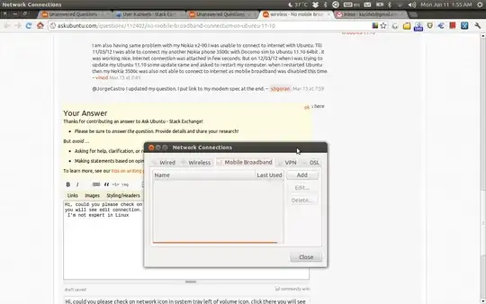

could you please check on network icon in system tray left of volume icon. click there you will see edit connection. click on that you will find Mobile Broadband. then "add".
Sorry in advance if I do mistake. I'm not expert in Linux.enter image description here
