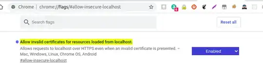

It works in Firefox without issues. For Google Chrome I had to enable the flag allow-insecure-localhost to allow local websites without correct security. This is done by opening chrome://flags/#allow-insecure-localhost and enabling the flag as shown:
chrome : Allow invalid certificates for resources loaded from localhost

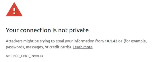

But Chromium didn't let me enter the site (not even under "advanced") chromium

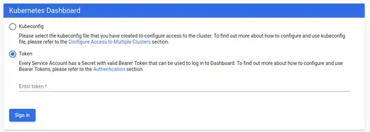

Thus I had to use Firefox where you will need to authenticate. firefox auth
You can authenticate with a token. To get the token run (dcoumentation):
token=$(microk8s kubectl -n kube-system get secret | grep default-token | cut -d " " -f1)
microk8s kubectl -n kube-system describe secret $token
Now you can copy and paste the token and you should be able to access the dashboard.
