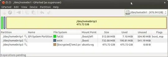

I am using LUKS for disk encryption for a Ubuntu 18.04 system. I'd like to find out how much free space is still available on my hard drive. gparted prints the following:
As you can see the entire disk is subdivided into three partitions. On startup LUKS tells me that the encrypted disk is called nvme0n1p3_crypt. However, there are nvme0n1p1 and nvme0n1p1 as well.
  1. Does this mean the are three partitions being all encrypted with the same key?
No, this means partition is in use - aka mounted. It's not recommended to edit mounted/in-use filesystems, since data loss can occur. The third big partition is not mounted according to the column in the screenshot

The /dev/nvme0n1p3 does not seem to have proper mountpoint (directory) and instead reports ubuntu-vg. Try the following ( source )
$ sudo mount /dev/ubuntu-vg/root /mnt
$ df -h /dev/ubuntu-vg/root
Since you're using lvm you should use sudo lvs preferably to find out what logical volumes are actually called.
This output seems weird, because the total available space is only 7,7G. This is not true as you can see above in the gparted output. The partition has roughly 475.75 GiB. Can you explain this?
It can occur when filesystem is not resized after partitioning, even with non-lvm cases. So if you have recently resized/repartitioned that device it could be the cause. Again, probably you don't wanna use df with lvm.
IIRC GParted doesn't really understand LVM volumes. Try the Disks tool.
  1. What does df / report? That would show the device mounted on /, which should be the encrypted LVM volume.
  2. df /some/file checks the filesystem on which that file exists. So df /dev/nvme0n1p3 is just checking the filesystem mounted on /dev.
  3. The filesystem on /dev is the udev virtual filesystem. Its size is the memory (RAM) you have (which would be around 8GB). That size has nothing to do with the hard disk size.
