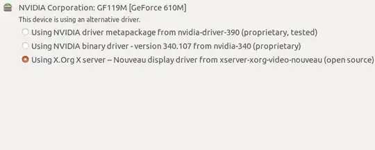

  • change the driver, currently I have: enter image description here
