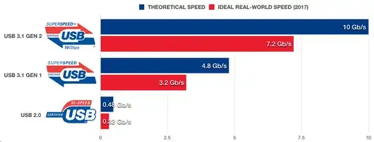

Disclaimer: First of all 3.0 have been renamed 3.1 GEN 1: enter image description here

  2. Is the speed important ? Is USB 2.0 Enough? Is there an interest to buy a 3.1 GEN 1 just for it?
