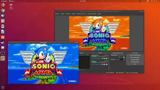

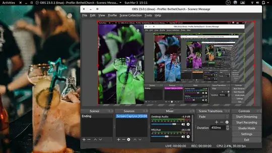

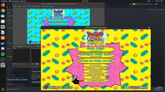

I tried to make a recording for gameplay of youtube and twitch but via obs but I found something very inconvenient. The colors are all inverted ... (or fading, I have no idea) I would like a help from you if possible Ubuntu I'm using is the 18.10 obs is the 21.0.1 enter image description here enter image description here

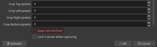

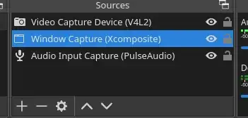

I found a better solution than the most upvoted answer:
Double-click your Window Capture:
Select "Swap Red and Blue":

I tried the fix suggested in a comment by Erikcht and it corrected the problem of inverted colours:
Select the source and click on engine.
There will be a checkbox for change red to blue and changing this fixed the problem.
