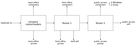

I've got a printer networking issue that I'm trying to work out. I work in a public library and our public access computers keep auto-installing the front office printer as well as the public access printer (which causes the patrons to print documents to our office all the time). This is a diagram of how the network is set up:
network
The modem is in the back office and has hard lines to the back office computers and printer. Router 1 is connected to the modem and is hardwired to the front office computers and printer, and is the staff WiFi router (wifi printing to the front office printer works when connected to this wifi.) Router 2 is connected to router 1 and provides public access wifi and the public access printer is connected to this router. The 4 public access computers are connected to router 2
