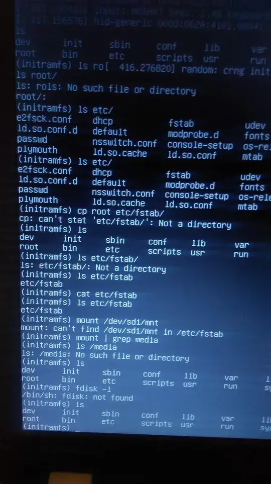

Here a snapashot of my current situation, you will see at the top of my image the list of folder in my "/" mount directory - ls command.
So that it, I don't know what should I do in particular, I'm very happy having manage grub rescue, now I would have advice about how handle my situation furthermore.
