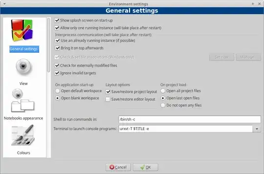

Then in CodeBlocks go to Settings -> Environment... then in the Terminal to launch console programs add the following:
urxvt -T $TITLE -e

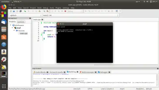

Save the .Xdefaults file and now you should get something looking like this:

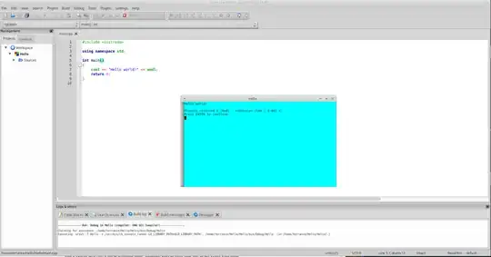

Or you can change background colors to whatever you want. Here's Cyan with Black text:
URxvt*background: cyan
URxvt*foreground: black
