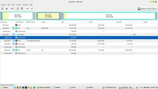

Back in the day i had dual boot(windows10) so i have a few NTFS partitions in my drive, but i deleted Windows long ago still not combined these part of my drives. I mount NTFS style but its not ideal. I want to combined some of NTFS areas to Linux file system.
Here's my current situation with gParted.
I can delete /sda2 its currently fully empty. But can deleting /sda2 make it combine with /ext4 ?

Yes, once you delete sda2, you have two options for expanding partitions into the space it leaves behind
  1. sda3 (extended) then sda5 (ext4 within extended)
    • I assume this is what you want.
  2. sda1 (ext4)
See How to resize partitions? for how
