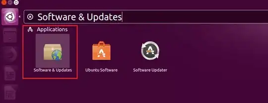

GUI method:
Open the program "Software and Updates"

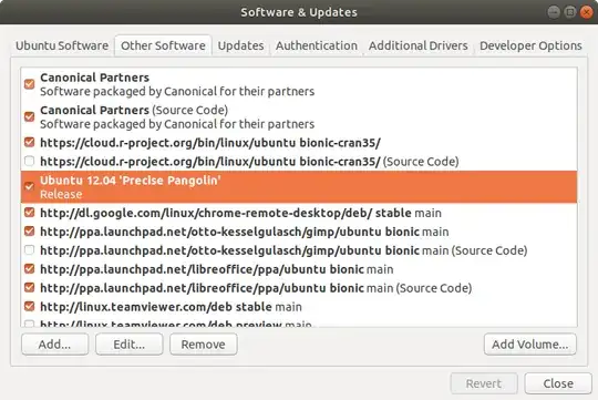

Then go to the Other Software tab:
Find each line that has precise on it. Highlight one line at a time. Press the Remove button at the bottom of the window.
Repeat for all lines with precise on it. These lines refer to obsolete repositories for Ubuntu 12.04. You are using Ubuntu 18.04, one of the currently supported versions.
