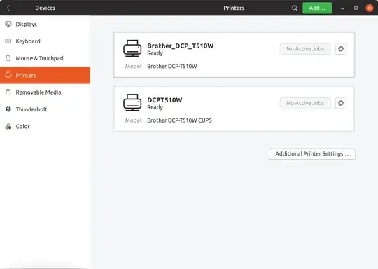

My printer Brother DCP-T510W, connected via WiFi, got automatically detected by Ubuntu 18.10, but its functionality was limited (like for example scanning didn't work).
Decided to install manufacturer's dedicated linux driver - that resulted in additional printer entry in Settings/Devices/Printers, but this one is fully functional (the second one).
Tried to delete the first, automagically detected entry, but it comes back right after deletion (whaaa?).
How can I get rid of the first entry then?
Already tried:
  • all cups related fixes found in net - didn't help (http://localhost:631/printers/ shows only the second entry though)
  • avahi configuration enable-dbus=no fix - this disabled the first entry, but it resulted in significantly longer printer discovery and other software experiencing some hickups.

One of the solutions might be just removing the avahi service by sudo apt purge avahi-daemon.
This results in proper, only one printer entry. enter image description here
