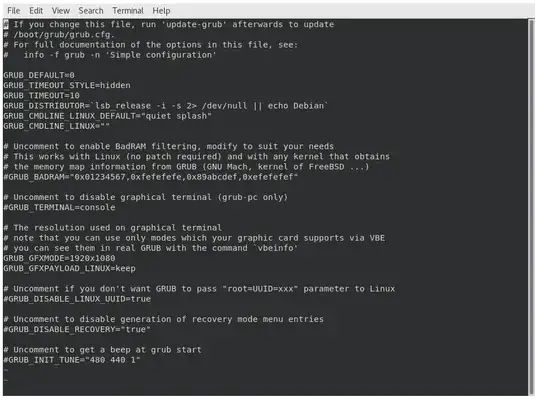

I have been using Ubuntu for quite sometime now. I have a dual boot system with Windows 10 and Ubuntu 18.04. I have used this combo ever since Ubuntu 18.04 came out. Earlier, grub would always show and accept 1920x1080 as its display resolution. I have had various system crashes along the way due to which I have had to install Windows and Ubuntu thrice. Recently, I have noticed a peculiar thing. My grub doesn't show 1920x1080 resolution when I use videoinfo command at grub terminal. The highest that it goes is 1280x720. I have tried to fix it by manually making an entry in the grub file but it was of no help.
My grub file config is as follows:
Can anyone please suggest me a possible fix for it? Is there something wrong with the OS? Is there something wrong with the BIOS (MSI Motherboard)? Is there something wrong with the drivers?

Edit the file /etc/default/grub and find the line:
GRUB_CMDLINE_LINUX_DEFAULT="quiet splash"
Then change it to:
GRUB_CMDLINE_LINUX_DEFAULT="quiet splash video=hyperv_fb:1920x1080"
See that this will sort out your problem. Also note the advice at the beginning of the file:
If you change this file, run 'update-grub' afterwards to update /boot/grub/grub.cfg.

There's very little video control at the GRUB screen level. It's best to leave /etc/default/grub at...
GRUB_GFXMODE=640x480
This parameter only effects the GRUB screen, and this setting will display large enough font characters for easy viewing.
Followed by...
sudo update-grub
Also see...
How to fix plymouth (splash screen) in all Ubuntu releases!
Nvidia Grub max boot resolution 1280x1024 (15.10)
Grub-Efi wrong resolution
