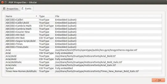

I have a PDF (generated from PowerPoint) that contains math characters which are not shown when viewing it with the default PDF viewer or Okular (greek letters, square root symbol, ... all appear as blank space). Checking the document properties these fonts are shown:
Fonts (not working)
It must have to do with the Symbol TrueType @ /usr/share/fonts/type1/gsfonts/s050000l.pfb since I have another PDF where this font is missing and all math symbols are shown correctly:
Fonts (working)
So it appears that Ubuntu thinks it knows how to handle that font but it doesn't seem to choose the correct file (?). How can I solve that problem?

pdffonts
$ pdffonts file.pdf
name                                 type              encoding         emb sub uni object ID
Arial,Bold                           TrueType          WinAnsi          no  no  no      11  0
Arial                                TrueType          WinAnsi          no  no  no      13  0
ABCDEE+Bookman Old Style,Bold        TrueType          WinAnsi          yes yes no      22  0
Arial                                CID TrueType      Identity-H       yes no  yes     24  0
ABCDEE+Gill Sans MT                  TrueType          WinAnsi          yes yes no      29  0
ABCDEE+Calibri                       TrueType          WinAnsi          yes yes no      31  0
ABCDEE+Cambria Math                  CID TrueType      Identity-H       yes yes yes     33  0
ABCDEE+Calibri,Bold                  TrueType          WinAnsi          yes yes no      38  0
ABCDEE+Gill Sans MT,BoldItalic       TrueType          WinAnsi          yes yes no      40  0
ABCDEE+MS PGothic                    CID TrueType      Identity-H       yes yes yes     55  0
ABCDEE+Wingdings 3                   CID TrueType      Identity-H       yes yes yes     67  0
Symbol                               TrueType          WinAnsi          no  no  no      61  0
Arial,Italic                         TrueType          WinAnsi          no  no  no      63  0
Times New Roman                      TrueType          WinAnsi          no  no  no      65  0
ABCDEE+Gill Sans MT                  CID TrueType      Identity-H       yes yes yes     80  0
ABCDEE+Gill Sans MT,Bold             TrueType          WinAnsi          yes yes no      85  0
Arial                                TrueType          WinAnsi          no  no  no     104  0
Symbol                               TrueType          WinAnsi          no  no  no     124  0
Symbol                               CID TrueType      Identity-H       yes no  yes    126  0
ABCDEE+Bookman Old Style             TrueType          WinAnsi          yes yes no     181  0
ABCDEE+Gill Sans MT,Italic           TrueType          WinAnsi          yes yes no     338  0
ABCEEE+Calibri                       CID TrueType      Identity-H       yes yes yes    353  0
ABCEEE+Calibri,Italic                TrueType          WinAnsi          yes yes no     358  0
ABCEEE+Cambria Math                  TrueType          WinAnsi          yes yes no     366  0

It appears that some of the fonts are not embedded into the PDF file, but we can fix that with the following command:
gs -dNOPAUSE -dBATCH -sDEVICE=pdfwrite -dPDFSETTINGS=/prepress -dEmbedAllFonts=true -sOutputFile=<my_file_embedded>.pdf -f <my_file>.pdf
This will take your input "my_file.pdf" and read through it looking for the fonts, embedding them as required and write the output to "my_file_embedded.pdf'
