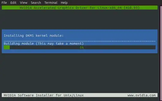

  4. Tried to install it. Got stuck here: enter image description here
  5. Reinstalled all the dependencies of the driver package, as described here.
  6. Repeated steps 3 & 4. Got the same response.
The installer gets stuck at 5% infinitely until the terminal window is forcibly closed.
