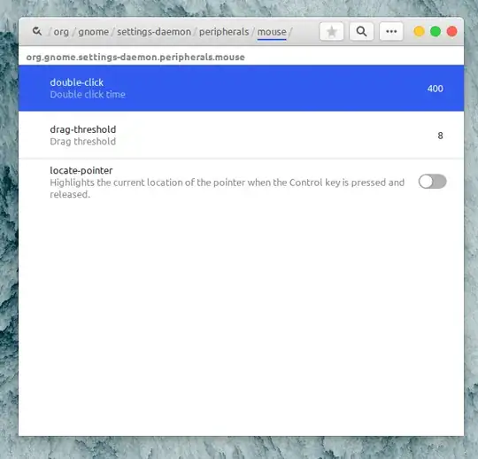

Searched for settings in dconf-editor for Horizontal scroll but didn't find anything:
dconf-editor mouse settings

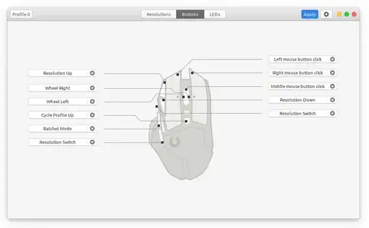

You can configure the mouse scroll if your mouse is supported in libratbag:
sudo add-apt-repository ppa:libratbag-piper/piper-libratbag-git
sudo apt update
sudo apt install piper
Piper Mouse
You can also configure RGB and DPI in Piper.
