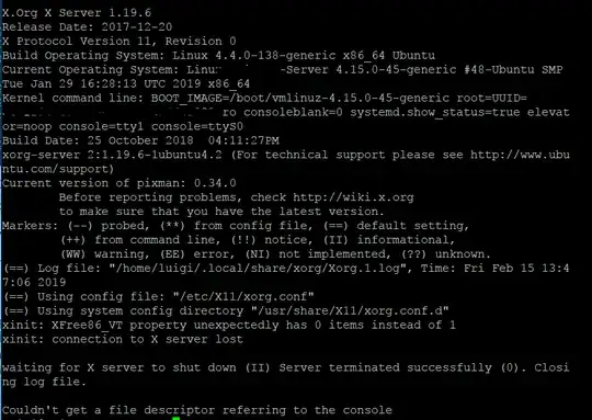

I bought a virtual server from hetzner.com and I am trying to get a desktop working. I already installed xrdp and gnome-desktop and I installed xserver-xorg-video-dummy and configured etc/X11/xorg.conf to create a virtual display but I just can't seem to get a desktop to run.
Startx outputs:
my /etc/X11/xorg.conf file:

The error log
Akisame
  • 3,343
You will need an external rdp client, else there IS no display that can be recognize
Also, you must tell xrdp to use GNOME and allow non root login (if desired). No matter the desktop, the first command is needed for non root user login
sudo sed -i 's/allowed_users=console/allowed_users=anybody/' /etc/X11/Xwrapper.config
echo "gnome-session" > ~/.xsession
The last command will be done with every user that needs to login via RDP
My advice, though, is use cinnamon, XFCE, or MATE. GNOME has issue with xrdp.
For cinnamon
sudo apt install cinnamon xrdp
echo "cinnamon-session" > ~/.xsession
For mate:
sudo apt install ubuntu-mate-desktop xrdp
echo "mate-session" > ~/.xsession
For XFCE:
sudo apt install xfce4 lightdm xrdp
echo "startxfce4" > ~/.xsession
Please also note you need a display manager (DM), which the server doesn't come with. Some desktops come with one, else I recommend lightdm
I also do not recommend VNC; it has performance and security issue. I usually tunnel rdp over ssh for security
