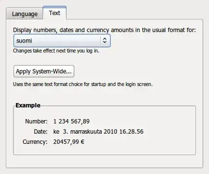

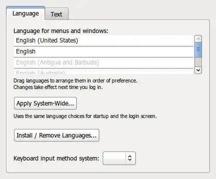

The Administration -> Language support settings look like this:
