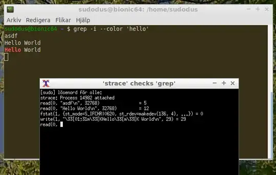

There is a lot of activity as soon as the cursor is in the terminal window.
Starting grep (waiting for input from /dev/stdin)
$ grep -i --color 'hello'
asdf
Hello World
Hello World
Checking it
$ running -s grep
ps -ef: active:
 'grep ...' is running
/usr/bin/xterm
checking pid=14982; quit with 'ctrl + c' in the xterm window
There is not much activity, and you can identify what is happening.
