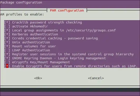

And then run pam-auth-update:
pam-auth-update
Check Enable EcryptFS for users from remote directories such as LDAP. and make sure that eCryptfs Key/Mount Management is unchecked. Leave all other options up to your preferences.
This will make sure that relevant configs in /etc/pam.d are applied and that they stay there.
