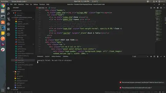

The default terminal in my VS Code has not changed back to Bash for some reason. Whenever I open the inbuilt terminal, an error message pops up:
The terminal process command '/usr/bin/zsh' failed to launch (exit code: 1)
screenshot of the error
I am just able to capture the screenshot - terminal gets automatically closed after fractions of a second.

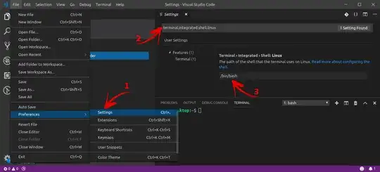

Try the following steps:
  1. In the VSC application open File>Preferences>Settings. Or press Ctrl+,;
  2. At this point you can browse the settings, or type terminal.integrated.shell.linux in the search bar;
  3. As value of the field Terminal > Integrated > Shell:Linux fill /bin/bash. Then restart the application.
Or, probably better, search for /bin/zsh and replace it with /bin/bash.

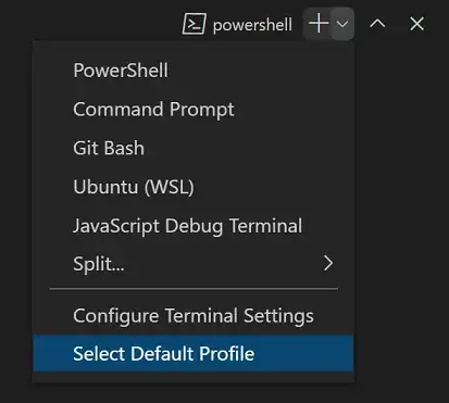

New and easiest way
Configure your default integrated terminal by running the Terminal: Select Default Profile command, which is also accessible via the terminal dropdown.
https://code.visualstudio.com/docs/editor/integrated-terminal#_terminal-profiles
