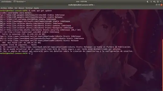

At the time of executing the command sudo apt-get update I get this error in the console. I have done several things to solve it, but I still have this problem.
Does anyone know what this is and how to solve it?
The first error on line 10, is because the url (linex.teamviewer.com) is not in use anymore. The second error is due to a change in how the repositories are configured and the update program is not able to do the update. It is likely that the program needing to be updated is no longer being supported, and the repository is not updated properly.
