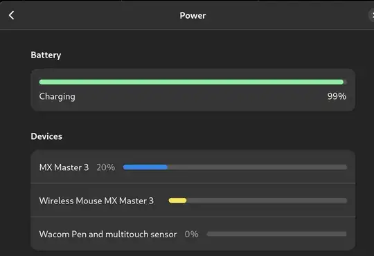

Before: Before bluez Experimental option enabled, Cloud Walker bluetooth headset is not displayed in Devices section of Power settings

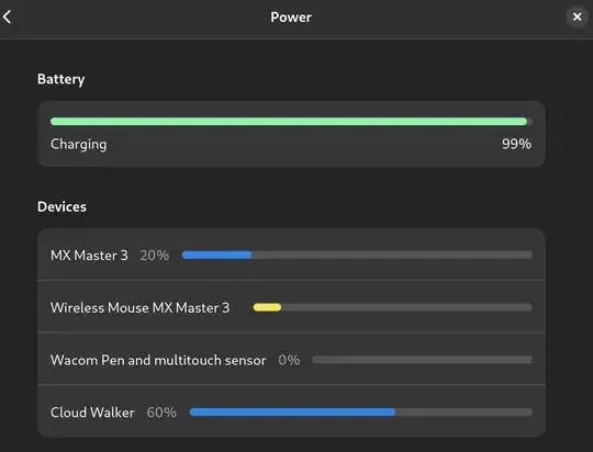

After: After bluez Experimental option enabled, Cloud Walker bluetooth headset is displayed in Devices section of Power settings

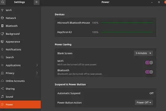

In ubuntu you can go simply to settings->power to see the battery status of system and connected devices.
Yes, I know it's a Microsoft Bluetooth mouse on a Linux System ... but hey, Microsoft is the new cool company now ;)

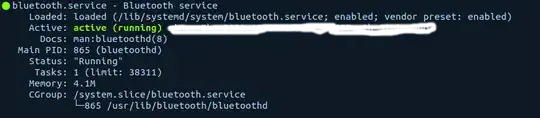

This is what: systemctl status bluetooth

The JBL was disconnected and the Creative speaker is connected with power. So the resulting ones with batteries (Keychron and Mouse) show up in the settings->power dialog.
NOTE: If upower -d not show the device, It's power level may not display in settings .
// I had a mouse shown, but a headphone not.
