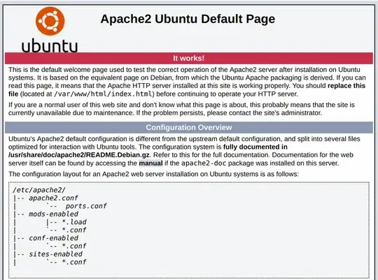

If it is installed successfully then type localhost in the browser. You will see something like this:
