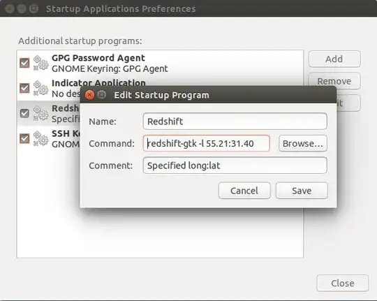

Another one way is to set up startup command for redshift with manually specified lon:lat like:
redshift-gtk -l xx:yy
where xx - latitude, yy - longitude
Startup Application Screen:
Tested on Ubuntu 14.04LTS
