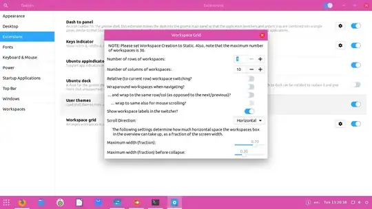

install "Workspace grid" gnome shell extension (https://github.com/zakkak/workspace-grid) go to settings and make number of rows and columns as per your wish.

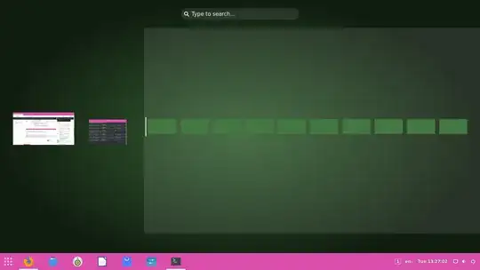

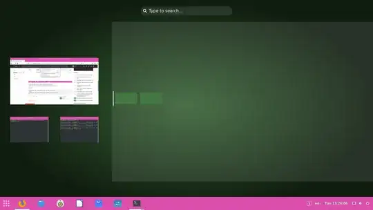

when dynamic-workspaces true enter image description here
when dynamic-workspaces false enter image description here

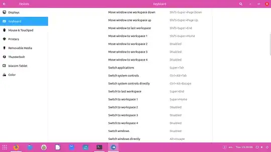

you can use the default keyboard shortcuts or set your preferred ones..
