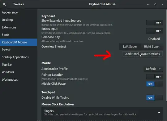

  1. Open gnome tweaks tool
  2. Go to Keyboard & Mouse

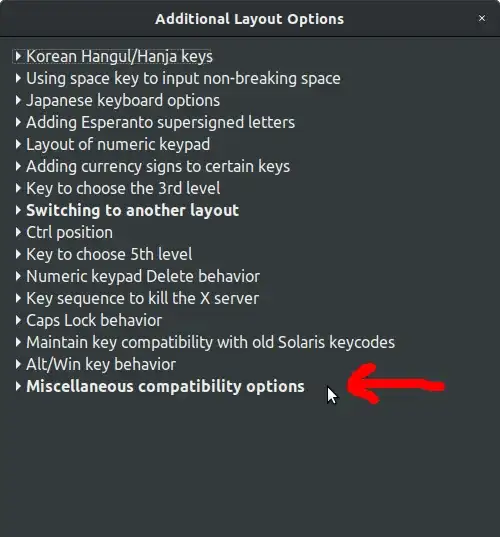

  3. Click on "Additional Layout Options"

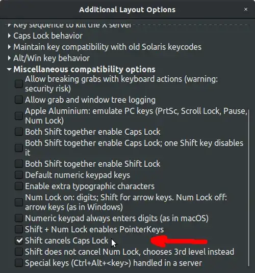

  4. Expand "Miscellaneous Compatibility Options"
  5. Check "Shift cancels Caps Lock"

  1. step-1:
    step-1
  2. step-2:
    step-2
  3. step-3:
    step-3
