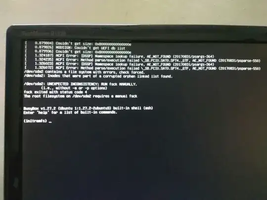

All of a sudden it started showing errors during startup and as I am not a pro user, I couldn't fix it. Can anyone help me regarding this issue? I have attached the following picture.

The best way to solve that issue is to boot to another Linux (you need to prepare Live USB with Ubuntu) and then open terminal and execute following:
fsck /dev/sda2
