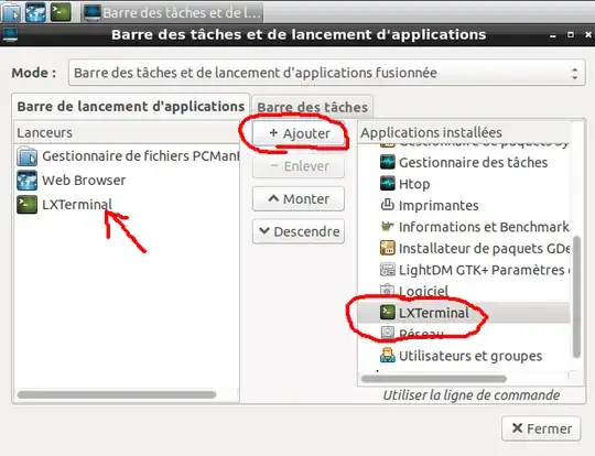

  3. Right-click on launchbar, go to "Settings" (the first entry): enter image description here and then add the terminal to the taskbar with the dedicated menu: enter image description here
