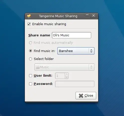

The Banshee Team recommended method is through an external application called Tangerine. This has the benefit over an embedded solution in that Banshee wouldn't need to be running for things to find music. An image of its settings UI running shows below.
