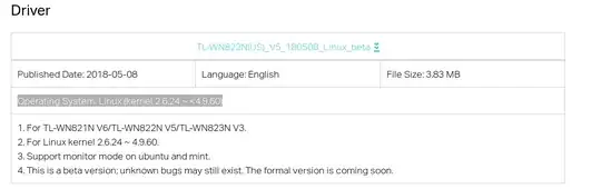

Ok here is an answer but you are not going to like it.
First, this link says: Operating System: Linux (kernel 2.6.24 ~ <4.9.60) and Ubuntu 18.04 has a kernel above that revision.
Second, the missing dependencies such as libelf-dev is not related to the aforementioned part. That's related strictly to your system config.
Third, I downloaded the driver myself as my system meets all dependencies so I gave it a go at compiling it regardless the fact that my system too uses kernel revision above the one suggested as "compatible". The first error I got was (no missing dependencies):
osdep_service_linux.h:299:8: error: ‘_timer {aka struct timer_list}’ has no member named ‘data’
  ptimer->data = (unsigned long)cntx;
That alone is a good enough sign to indicate that the new kernel has removed this member. Nonetheless, I kept going and I commented that line out (really bad idea, don't ever do this but I am in a VM so I don't care if I lose any data in it, but anyway I just wanted to see how far I will go...). I really wanted to compile that thing and see what happens so here is my mod:

Let's do a ls *.ko and we have ourselves a freshly compiled 8192eu.ko
Let's see what it is:
8192eu.ko: ELF 64-bit LSB relocatable, x86-64, version 1 (SYSV), BuildID[sha1]=a4eae30125a8c332ccb8da9a86eebbe42be8ef57, not stripped
Right, the manual says:
enter image description here Ok then :) fingers crossed:
insmod: ERROR: could not insert module 8192eu.ko: Unknown symbol in module
So, what did we learn here? It won't load hence for the linux kernel version compatibility. Something has been removed from the newer kernel revisions that make the current code base incompatible.
I really hope you get it running somehow. What I have done above is the most I can do right now.
