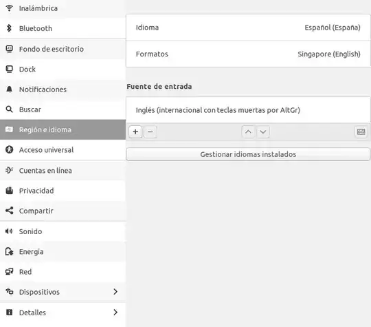

My Ubuntu 18.04 is set to Spanish:
But man pages are displayed in English, not according to the configuration (Spanish).
