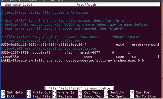

open up a terminal and run sudo nano /etc/fstab. This will give you a file that looks something like this:
/etc/fstab
To make a drive read only here (let's assume your NTFS partiton is /dev/sda1) add a line to the bottom that says /dev/sda1 /mount/point/path auto ro 0 0
Once that's done, run sudo umount /dev/sda1, then sudo mount /dev/sda1, which will respectively unmount from your old options and remount with your new, read-only option.

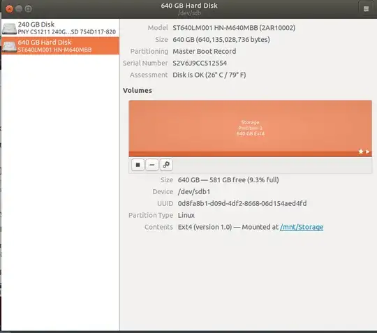

Run the disks utility from the search menu, or run gnome-disks from the CLI.
gnome-disks

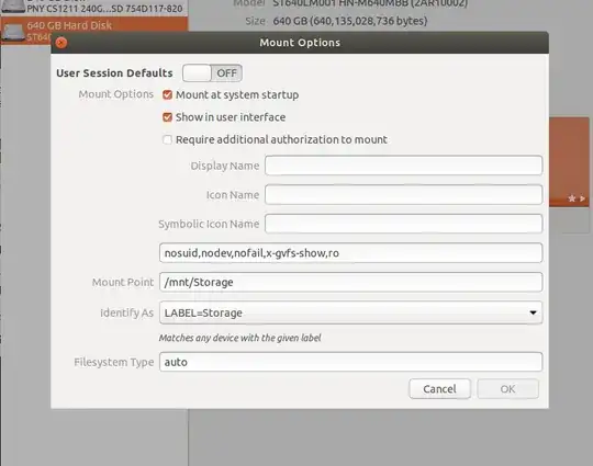

Select the device with the partition you want to make read-only, then click the gears beneath the "Volumes" section, and click "Edit mount options"
gnome-disks menu
From here, simply add 'ro' to the end of the string beneath the "Symbolic Icon Name" field. You can also choose a mount point here other than the one the system designates.
Once that's done, simply unmount and remount your drive/partition from the previous screen, and you're done; no more accidental overwrites (unless you use dd)
To remove the read only condition, you can either edit your /etc/fstab file or pull up gnome-disks again and remove the ro; basically the same thing you just did, but in reverse.
