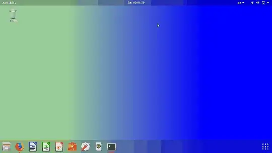

I could do this with the below way..
  1. create a script named cl.sh on Desktop to run the command /usr/bin/gnome-desktop-item-edit ~/Desktop/ --create-new with below content.
    Content of the script
    #!/bin/bash
  2. cd ~/Desktop
  3. Make the script executable with chmod a+x cl.sh
  4. Open the "Create Launcher" with ./cl.sh
    A dialog "Create Launcher" will pop up.
  5. Give the command as /home/user/Desktop/cl.sh Replace user with your username
  6. Click the Icon on Desktop and click trust and launch.
