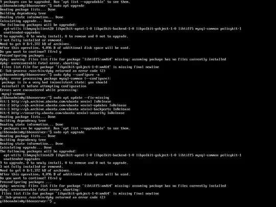

When I tried to update and upgrade packages, I got error messages which I include below. apt update works as usual but the apt upgrade command causes an error. When I run dpkg -- configure -a, I get other error messages. I have tried removing and purging the packages mentioned but nothing seems to work.

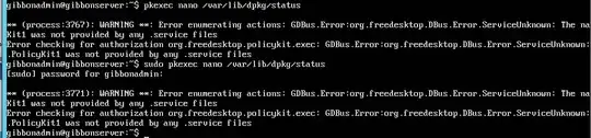

I have tried the solution suggested but get the following error message:
Any ideas? This screen has the original errors...
