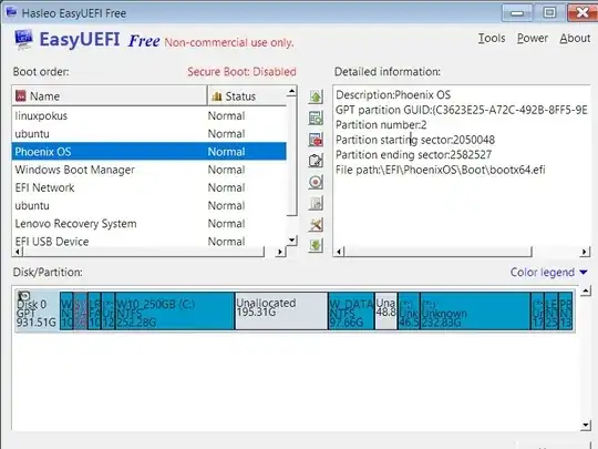

I followed advice and after reboot to Windows this is output of EasyUEFI: EasyUEFI list of boot entries.

There are (usually) many items. So, if you see it for the first time you may get lost. I think the best is to compare it with EasyUEFI outup. See in picture in question:
File path:\EFI\PhoenixOS\Boot\bootx64.efi.

I did not care about "Windows Boot Manager" important is path for identification. Next you have to copy UUID (=identifier item) {1eaad893-dede-11e7-bfa7-b5e08c6024df}. (It should vary in your case). And delete this entry by:
bcdedit /delete {1eaad893-dede-11e7-bfa7-b5e08c6024df}
I did reboot. But I think it is not necessary. Now, you should not see Phoenix OS boot entry either in EasyUEFI nor by bcdedit /enum all nor in BIOS boot options. That is it.
