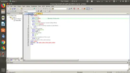

After that I have experienced two issues:
  1. Could not open file.
    Error 56 can't open the file
    That was solved by rebuilding the project. Check the directory and rebuild the project.

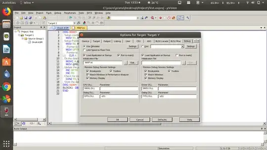

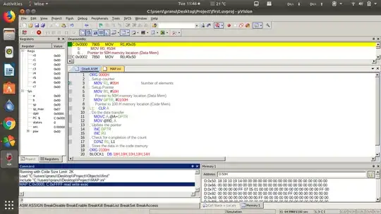

  2. Some issues with memory mapping.
    *** Error 65: Access violation at 0x00000004 : No 'write' permission
    To solve this problem I created MAP.ini and placed this code inside MAP.ini saved in /home/usr/Desktop. Then in Keil go to project options: Ctrl+F7 → Debug → Select the initialization file MAP.ini by browsing to the specific folder. Put the code in MAP.ini without "": "MAP C:0x0000, C:0xFFFF read write exec"
Keil Setup for MAP.ini File
Keil Screenshot1
Keil screenshot2
NOTE:Make sure your .asm or any other file including MAP.ini has permission read/write for other,group and owner
